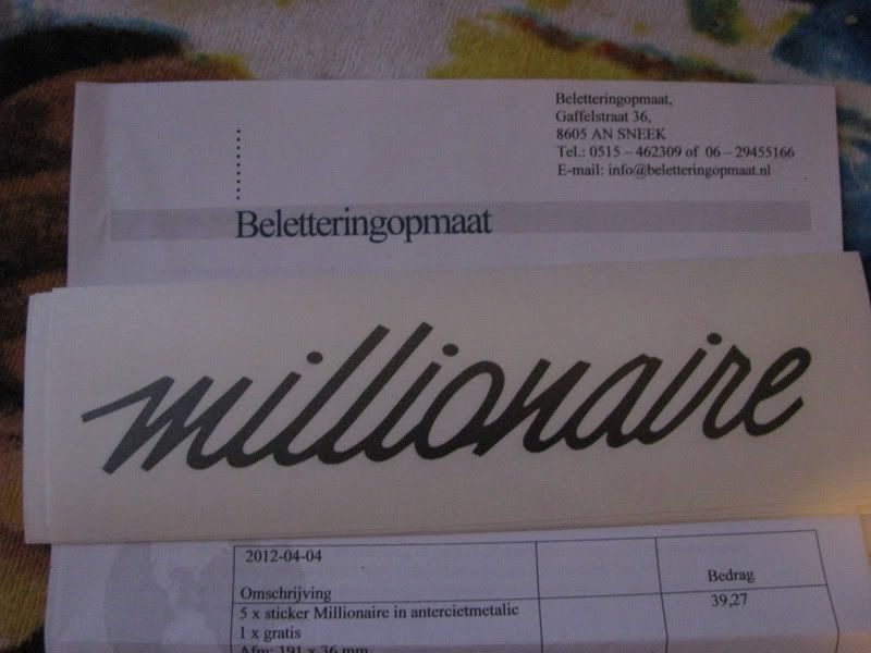

Edit:
De foto van millionaire-stickers is weer weg, hier de link: i841.photobucket.com/albums/zz334/Genera...llionairesticker.jpg
