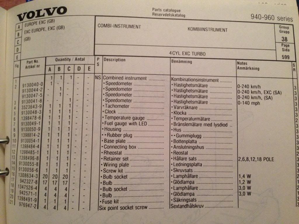

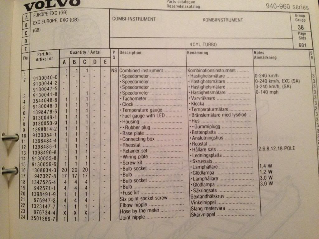

29-11-2013 09:45 #1398057
door Jerry Stam (GAST)
Beantwoord door Jerry Stam (GAST) in topic Onderdelenboek uit 1994
<img src="
i1094.photobucket.com/albums/i456/Jerry_...null_zps609a06bc.jpg
<img src=" i1094.photobucket.com/albums/i456/Jerry_...null_zps36b9a7bb.jpg " width="1024" height="768" />
<img src=" i1094.photobucket.com/albums/i456/Jerry_...null_zpsa28f2146.jpg " />
