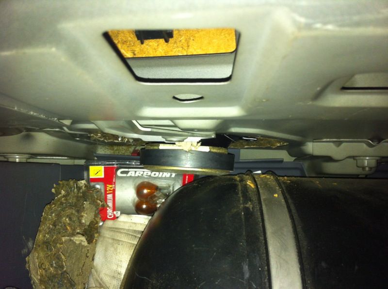

Beantwoord door V700 register in topic 20 mm ophoogringen maken
<img src="
i160.photobucket.com/albums/t170/aandrie...3957_zps54035185.jpg
" width="800" height="597" />
i160.photobucket.com/albums/t170/aandrie...3958_zpsbd1de4e7.jpg
