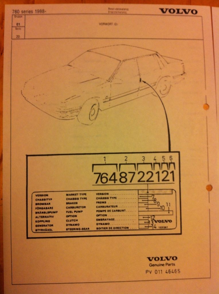

Plaatje achterin (van de 760) betekent
<img src=" i1094.photobucket.com/albums/i456/Jerry_...00000DB868FA322A.jpg " />
<img src=" i1094.photobucket.com/albums/i456/Jerry_...00000DB8BE982090.jpg " width="764" height="1024" />
