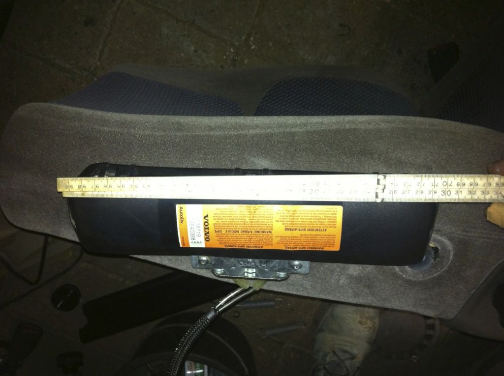

14-06-2013 09:57 #1389151 door V700 register
Beantwoord door V700 register in topic De Sips plofzak
<img src=" i160.photobucket.com/albums/t170/aandrie...file_zpsb8900b7e.jpg " width="1024" height="765" />
